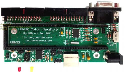

Mick designed the UBW32-MCC-PCB:
http://www.dontronics-shop.com/ubw32-mcc-pcb-letter.html
and obviously noted the differences and tested it both ways:
See R12 near the SD card. He has it shorted out.
I spoke to him this morning about it. His response:
I also ran with it shorted as can be seen in the actual picture R12 just above the power jack.
So I don't think its critical.
Don...Edited by donmck 2012-10-20

Are you referring to my UBW32-MCC PCB? If so then I believe your problem might be with the soldering associated with the G3 and G4 pads on the microSD socket.
You can test the function of the switch (G3 and G4) by using a meter to measure between GND and the pads for D5 and D6 of the UBW32 connector (see layout below). With a microSD inserted you should see GND appear at D5 and D6.
If you dont get a GND connection on D5 and D6 (pins on the UBW32) then MMbasic will not detect the SD card at all..
You could prove this by shorting D5/D6 to GND and seeing if you can read the SD card then.
The Pad for G3 is extremely hard to solder so I soldered it to the case first (the case is GND and the Pad should connect to GND so it makes it easier...
I have a fair bit in the manual about soldering the uSD socket... maybe you saw an earlier version of the manual... Get the latest one HERE
