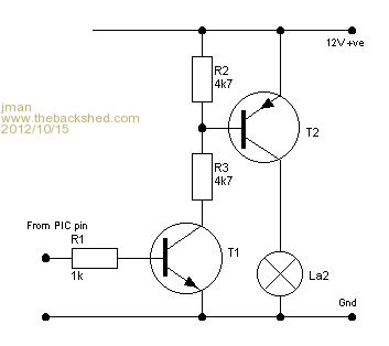

Circuit below
one other observation if I read the pins as analog pin1 reads 0v
the other pins2-10 read 1.4v
Starting look like the PIC's are faulty but both ?
John Edited by jman 2012-10-16
Posts: 2984
Posted: 07:58pm 14 Oct 2012
Hi John,
I cant fault that circuit... It SHOULD work so there must be something else wrong

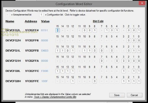

If you have access to a pickit3 try flashing in this HEX file (which is the one I used on my UBW32) it was emailed to me directly by Geoff.
2012-10-15_055646_ColourMM_MMBasic_V4.0.zip
It may be that a config bit has been set incorrectly..
I am not really an expert with the programming of the Pic32 using the PicKit3 but I have done it several times. I know there are some config bits but i havent played around with them.

jman
Joined: 12/06/2011
Posts: 711
Posted: 08:30pm 14 Oct 2012
Hi Mick
Yip device is correct
Here is a screen shot of the config bits
Only odd thing is I am using a Pickit 2 to do the programming
once again thanks for all the help
jman
Joined: 12/06/2011
Posts: 711
Posted: 08:52pm 14 Oct 2012
We have a WINNER
I re-programmed the PIC using Pic32prog and now pin(1) works perfectly
config bits maybe ?
Thanks for all the help
