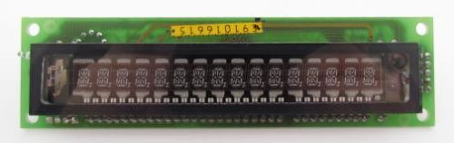

I've had a couple of these display modules setting around for a while. They have a 10-pin connector, not the 'normal' 14 that an LCD module has. I also don't have a data sheet for the display, but a couple of old data sheets for different displays. Every time I bump into the modules in my box of stuff I wonder what they look like when activated.
But it has always been a bother to try to figure out if any of the datasheets apply, if any do at all.

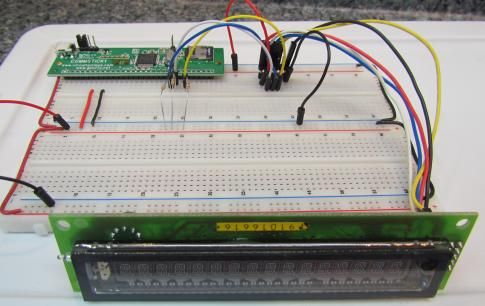

Today I decided to wire up the display to a CGMMSTICK to play around with them. It is a 5V display, so I used OC outputs pulled to 5V through a 10k resistor. The display has a reset line, data in, and clock. Data is most significant bit first.
Pins 2, 4, 6, 8, 10 are ground
Pin 1 +5V
Pin 3 clock
Pin 5 data
Pin 7 reset

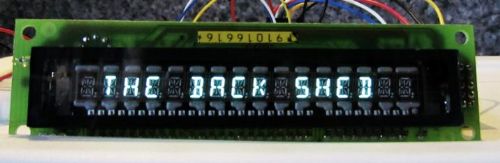

And the result:
I don't know if any displays like this one show up as surplus, but if they do, this test code will help get them working.
