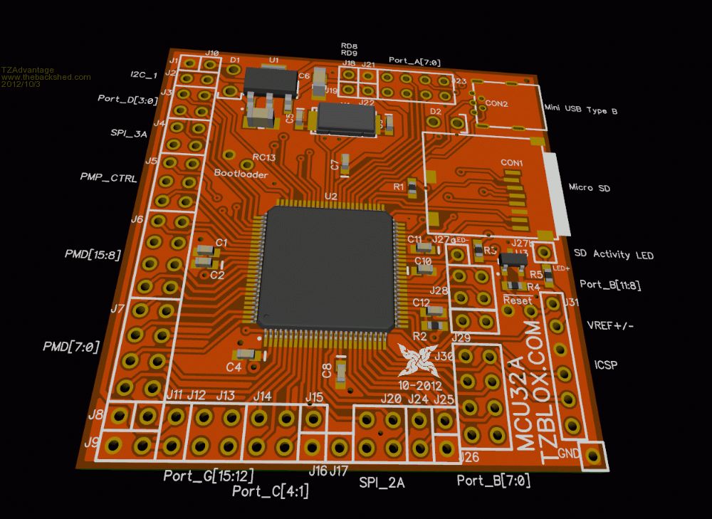

I am in the final stages of designing a very small PIC32MX795 board.
It measures 50x49mm and breaks out all of the pins to headers, a few are used for onboard functions like sd card, USB and ICSP.
Every peripheral is available. Plan is to not use 'bitbanging' for anything and use the internal hardware.
Power connectors are lined up for use on a breadboard and when you use female headers prototyping fun can begin. :)
I would like it to run MMBasic, probably have to change a few port/pin numbers to get it working. The monochrome version would be easy as only one connector is then used up, the color version is better for desktop use (my son loves it). A version with just a terminal via usb and keeping all the ports available is very handy when interfacing to the outer world. Of course all choices are open so programming it with the ICSP using one of the C compilers from Microchip or others is possible.

WOW ... your board size is only 2 inch x 2 inch
Closer PIC32 I/O pin inspection reveals that some/many of your PMP (parallel master port) pins conflict with those of the MaxiMite. Using MMBasic could be bit of a problem?
Edited by DuinoMiteMegaAn 2012-10-04
Posted: 10:10am 03 Oct 2012
A color maximite would not have any serial/spi peripheral available. A monochrome maximite (duinomite version) will have 2 spi, 2 serial or 2 i2c available.
However nobody will stop you using those pmp pins for other purposes. Like a can bus. :) :)
A can bus will make the PMP 8 bit instead of 16 bit, but it will still be usable.
It is just that if it has to be more open to other programming it is really essential to have the peripherals in the PIC available.
The only thing i really could not manage was using the same SPI port the maximite uses for the sd card. The traces would be all over the board, or the sd card had to be in the back. :)
Modifying MMBasic for that should be easy.

Posted: 10:41am 11 Oct 2012
I exchanged some email with Geoff and a good point was that if it should be able to run MMBasic it should be easy to upgrade it with new versions without having to modify it every time.
I agree with that of course. The wish i have is that the board should be more open to other programming at the same time. The only way to accomplish that is to move the sd card to another board.
The rest can remain the same because no pins except the usb are used. The usb is wired exactly like a maximite anyway.
I am currently modifying the design to remove the sd card and replace it with a header.
I will make another small board that can be connected on the underside with all the maximite specific pins and connectors on it.
This will then result in a colour maximite clone with a size smaller then 2"x2".
You would then be able to design and prototype a system with a normal maximite for comfort (vga screen/keyboard,etc) and then drop this board in place to have 'product' freeing your maximite for the next project.
