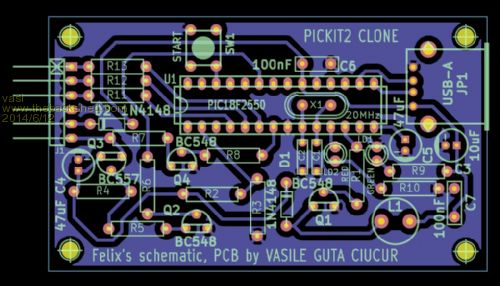

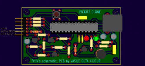

vasi
Joined: 23/03/2007
Location: Romania
Posts: 1697
Posted: 04:29pm 08 Jun 2014
What about a single side DIY PCB in KiCAD?
And the gerber files displayed inside gerbv linux app.
Edited by vasi 2014-06-13
