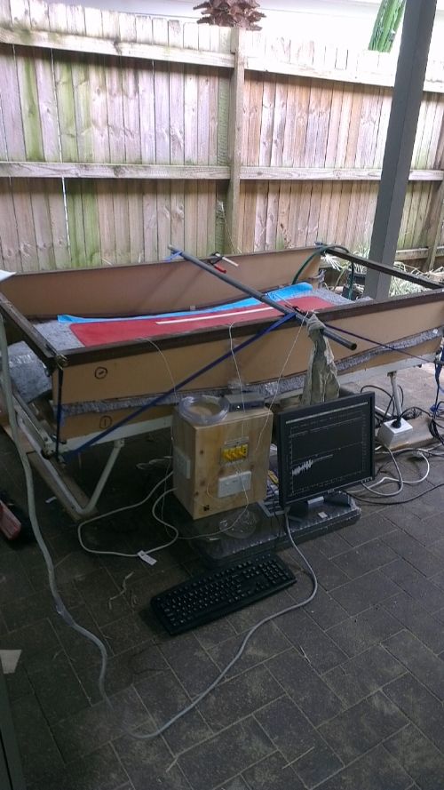

I recently built a monochrome Maximite and decided to make use of it in one of my other pass-times which is building composite kiteboards. The kiteboards are epoxy, fibreglass and carbon fibre constructions and so the c. 48 hour curing process usually involves working with vacuum bagging and elevated temperatures. So I decided to put some effort into making a process controller using the Maximite and have today largely finished it
The controller has 4 temperature sensors, 2 x 0-30 psi pressure sensors on board and 3 relays that can switch 1 kw loads such as the vacuum pump, silicone heating blankets or lamps. The Maximite then provides the intelligence part of the controller.

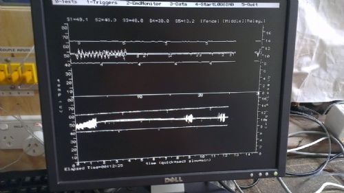

iii) Plots simultaneously on 2 separate charts so that you can view on a short time scale and long time scale chart

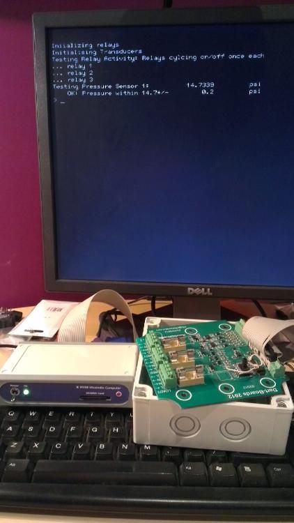

Here are a couple of snaps of the finished board, cabinet and the screen shots.

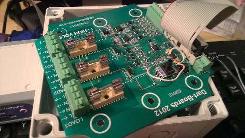

close up of board. A slight issue with the PCB board meant a work around on the pressure sensor ( 40% of the cost of the project in that one component!)
The very first test

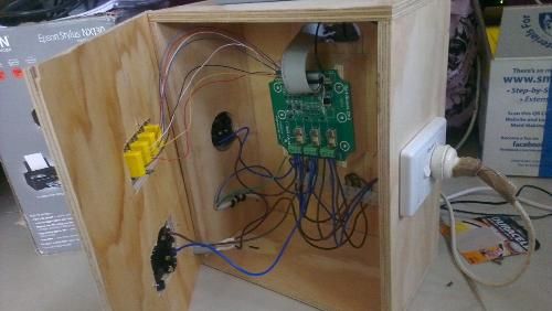

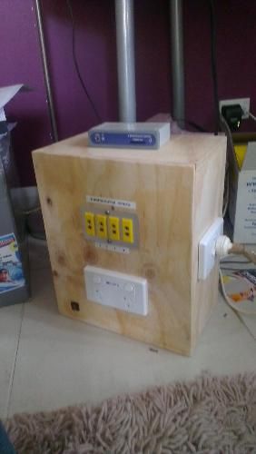

"Generous" Cabinet to house it. Has 4 thermocouple inputs for temp sensors and 3 240v sockets connecting to the relays.

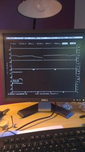

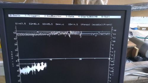

Screen shot of the charting function showing the split screen short and long time scale plots. The traces wrap at the end of the chart and overwrite the previous sections so you can always see a period equal to the time scales.

If I've interpretted your circuit diagram and your photographs correctly, may I raise a word of caution?
It appears that you have an incoming 240V supply (left of photo) supplying the 3 x 240V circuits via the relays.
There does not appear to be any earth conductors to the socket outlets.
AS3000 requires that all socket outlets have the earth connected.
Perhaps I have misinterpretted your information? If so, apologies.

Thanks very much for posting me on this. You are right that the photos don't show any earth connections and this was a v. dangerous oversight that I am in the process of fixing. The earth for the 240V input is just available and I'm going to install another bus bar connector and wire up the earth on each of the sockets.
I have to admit to a moment of ignorance when I was making the housing. I thought to myself there's no way a wooden box could be be live. Which is true in the same way as saying it doesn't rain in my house is true but also not the point

AS3000 is the Australian and New Zealand Wiring Rules(Actually AS/NZS 3000:2007 Electrical installations (known as the Australian/New Zealand Wiring Rules)).
Its application is mandatory in all states.
"Clause 5.4.2 Socket-outlets
The earthing contact of every socket-outlet shall be earthed."
Hope this helps.

A brilliant project, but I have a couple of questions.
At the start of the software you say you are using pins 11, 12 and 13 for the relays and then you use setpin 18,19 and 20 for digital outputs, this does not seem to gel with the circuit diagram.
Or am I missing something.
The same goes for the thermocouples the pins you allocate arent the same as the circuit diagram.

Thanks Centrex. Mate, well spotted! The pins being set in the software are the correct ones.
Unfortunately there were a couple of mistakes in the PCB layout. The relays and the 26 way IDC connector the bottom views were confused for the top views when inserting the pin assignments. This meant that the relays needed to be inserted from the underside of the PCB (they have offset pins - this is why they aren't visible in the pictures) and so too should the connector have been except I discovered it too late. The work around was to change the pin assignments. The only problem with this was that one of the pins on the circuit diagram earmarked for relay control was actually connected to 3.3V. This meant I had to move the wire in the ribbon cable so it connected another pin. I think installing it on the underside would have been cleaner.
There was also another error on the PCB with the pressure sensor the output should have been on pin 3 but was drawn as being on pin 4. ( The work around being the wire hookup wire you can see)
I have the gerbers and some other documentation on the controller if you are interested in them. I don't have any PCB cad software to fix the issues but if you do your more than welcome have them.
