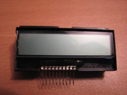

I euthanized a misperforming printer/scanner at my work in search of useful parts, and one of the things I found was a LCD-screen, possibly 16x2 chars, with 10 pins. Problem is, that I never thought about checking how many chars it displayed or even the brand of the printer (might be Lexmark or Epson, it was very cheaply made anyway). So I'll now try to see if anyone here can guess the pins or even recognise the LCD...

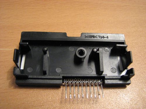

I desoldered the screen from a board that only had some resistors and momentary buttons, there was no driver chip on the board so my guess is that it's integrated under the screen.
Would be cool to be able to use that screen for text output.

Well, it does not work, think I might have damaged the screen somehow, but found another screen in a dead low cost Canon Pixma MP220, the screen is 16x1, but it actually behaves like a 8x2 screen, but that does not matter.

I have tried that combination before, but I desoldered all the wires from the pins and mounted it to a prototype board now with your pinout, still no luck... Then i thought that i had nothing to lose so I disconnected it from the DuinoMite took a 4.5V battery pack and placed the negative lead on the first pin and the positive lead on random pins, then on pin 3 the screen came to life, displaying random garbage chars.
Turns out that the only problem was that 3.3V was not enough for the contrast pin, so with a 10K pot on pin 3 that goes to ground and to +5V everything no works. :)
This screen is even more odd than the other one, it's a 1x16 screen that behaves like a two line screen also, but to get a full 16 char line printed out one has to print first 8 chars on line one, and the following 8 chars on line 3.
