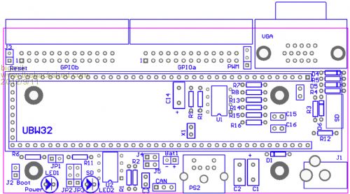

I have designed a PCB to convert a UBW32 to a CMM (based on Geoff's cct) as shown in this overlay. The design is complete but I need to check a few things before I commit to manufacture.
The PCB itself is 116mm x 56mm and is designed to go into a neat little box that is in total only 120mm x 60mm x 24mm. The point I had was that people dont go and buy a small board like the UBW32 and then stick it into a shoe box... they want it small...
The PCB has the following features:
Standard 26pin GPIO header.
A second GPIO header, (see comment below).
The RTC components.
VGA and PS2 keyboard socket.
`push in/pull out' micro SD socket.
An MCP2551 CAN driver.
Power jack for (7.5-9Vdc).
(USB input will be using the UBW32's own connector)
On the underside of the board (in the blank area under the UBW32 chip), there is a jumper pad area so that the GPIOb header can be configured either as high order Pin(x) in the same pattern as the first GPIO or alternatively can be jumpered to suit the existing Dontronics DonDuino Cross if an Arduino footprint is desired.

I have to be 100% sure that the sizes of my components are correct as I have pushed everything together so close that 1mm may be the difference between it `physically' working or not. I also wish to check the micro SD socket which is a type I have not seen before... it had to be this type to enable it to fit. I chose a `push-in, pull out' Molex type and I need to makesure that it fits the footprint I have created for it. It is also a surface mount (as these all seem to be) and will need a bit of experience to solder.
I hope to place my order this coming week.

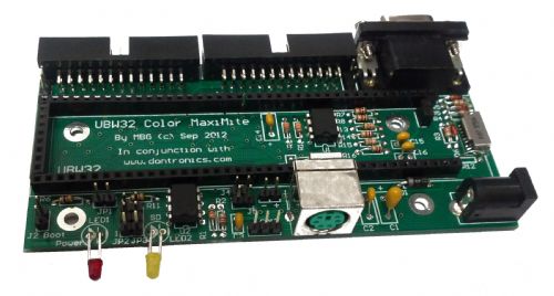

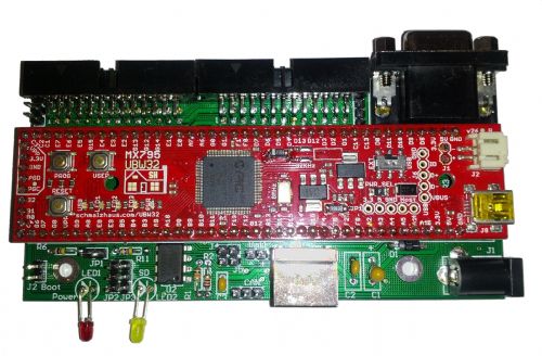

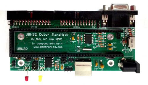

The PCBs have arrived and I have tested most aspects of the design and to date all functions are working as expected..
Sections still to test are:
PWM/SOUND (not geared up at the moment to test sound but hopefully tomorrow)
CAN... I have the MCP2551 chip installed but I personally dont know how to test CAN
Here are a couple of pics of the built up unit: (The 3rd picture shows the UBW-32 installed and it looks like the UBW-32 overlaps the PCB area but this is an optical illusion as the UBW-32 fits within the confines of the UBW-CMM PCB completely)
As with all designs there are some regrets and errata.. This project is no different.
In an ideal world I would have done these things differently.
First a couple of caveats ... The microSD socket is NOT a super easy thing to solder (I was able to solder it with my 54year old eyes and a pair of high mag glasses) and it needs a good iron, good light and clean, sharp pointed iron to complete.
If you wish to use the small case I have designed this for, the female headers for the UBW-32 to plug into need to be low profile ones (I used 5mm ones) which are not really cheap (about $8-10 for the set) and not really easy to find. The standard 8.5mm females are just a bit too high but can still be used in the case if you remove the white J2 header from the UBW-32.
Regrets/Errata
I regret that I neglected to give Geoff credit (on the overlay) for the basis of the design of the UBW-CMM board as it is almost an exact duplicate. I will make sure this is noted in the documentation.
The connector for the coin battery is at .1" spacing instead of 2mm spacing so the wires from the battery will have to be either soldered directly or onto a .1" female header.
The holes for the main Power socket are too large (Thank god for solder)
A couple of capacitors have a 0.200" footprint when they should be 0.100" (no big deal)
The PWM/Sound header and the CAN header are a bit cramped for space but still workable.
Apart from all of that I am quite excited about the project overall.
Don has negotiated with me for the distribution of these and he will be handling the Bare PCB sales see the following web links for more information.
PCB
PCB-Letter
There have been a few people interested in full kits and/or soldered uSD socket.. I can handle these but I have not as of yet worked out a price and I dont see myself cutting out cases, however if interest is there I may supply the case as well. These can be discussed privately via PM if you wish and I have no real idea of costings yet.
My biggest problem with the supply of parts/ soldered uSD etc is that the busiest time of my working year is upon me and wont ease till mid November (I work in the racing industry and will be at the Melbourne Cup amongst many other meetings)
