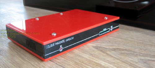

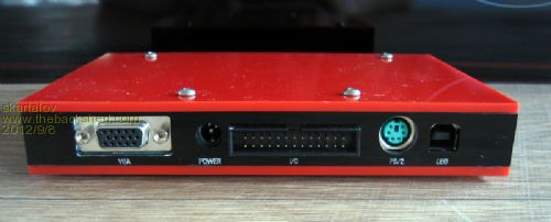

Hi guys,
the colour maximite is really great project. I had a lot of fun building it.
So finally I decided to give it a "fresh modern" look, so I build stereo speakers inside the box, cut the panels from Acrylic, glued all together and here is the result:

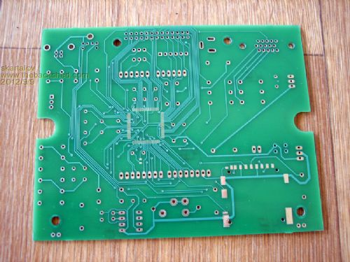

Can you post or share a picture of your Color MaxiMite printed circuit board?
skartalov
Joined: 07/09/2012
Location: Bulgaria
Posts: 12
Posted: 08:19am 08 Sep 2012
  DuinoMiteMegaAn said   @skartalov
Sure I will, but wait until monday, when I go to my work...
Here it is! It is made from the original gerber files, freely available at Geoff web site.

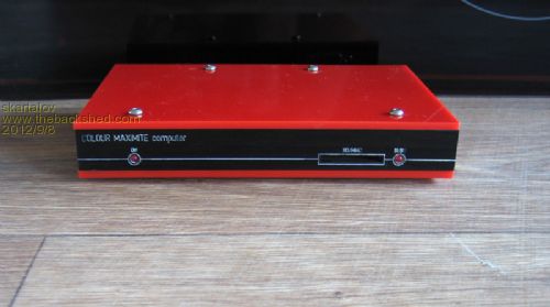

  bigmik said   I especially like the colors, (red and Black) suits my favourite aussie rules football team (Essendon Bombers).
Than you should like this unit even more :-)
This is best I can give, regarding design of the box.
