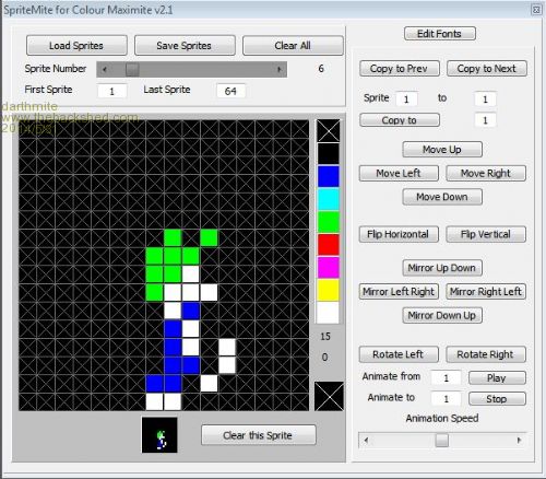

Hi
Long time without posting something made my fingers become nervous
Nick the SpriteMite 'beta tester' have give me some idea and
tell me where he see bugs and what was to do to made the soft better.
Now the soft can :
Get actual Sprite and :
-copy to next
-copy to previous
-take Sprite number1 to number2 and copy them to number3 (this work in reverse mode too).
-Move Up
-Move Down
-Move Left
-Move Right
-Flip Horizontal
-Flip Vertical
-Mirror from Up to Down
-Mirror from Down to Up
-Mirror from Left to Right
-Mirror from Right to Left
-Rotate 90 deg to Left
-Rotate 90 deg to Right
That was for the Sprites Edition.
You can show the Animation from them too.
Just enter the 1st Sprite from the Animation Set in 'Animate from' and the
last Sprite from the Animation set in 'Animate to" and press the "Play" Button.
Slide the Animation Speed for made it faster or slower.
Press the Edit Fonts button and here you can edit new character for made
your own fonts set.
Best is to try yourself for your Colour Maximite projects.
Here it is : 2012-09-02_145611_SpriteMite.zip
They are two executables in this archive.
SpriteMite_x32.exe is for win xp,vista x86 and seven x86
SprMite.exe is for vista/seven x64.
Anyway , thanx to Nick who put allot time in testing this soft and
helping me to made it better
Cheers.
Darth.
Edited by darthmite 2012-09-03

Your screenshot shows the colors reverted too. From the first Colour MMBasic release, Green has been 2 and Cyan 3. You have them the other way around in your source code. Save that Lemming sprite and load-it into a Maximite - you will notice that the hair will be Cyan instead of Green

I reverted the Lime and Aqua colors.
After adding only ONE line of code we can now add comment everywhere after the
header block.
Take the new source : 2014-06-01_100526_SprMite_v2.3.zip
Enjoy.
PS: With the new colors my Lemmings are now Ugly !!
