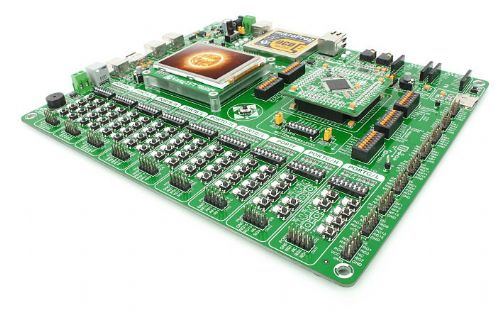

Well, I said it few times - develop on PIC24 and burn the final application on PIC32.
Mikroelektronika did it:

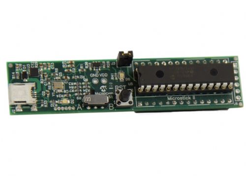

You could just use the Microchip Microstick II. It even comes with a PIC24F, PIC24H, dsPIC33 and PIC32 DIP and built in programmer/debugger. All for $35. Plugs right into a breadboard.

Of course I don't have money for that board but if it is to be 100 pin PIC24/32 development board, then it has to be that board. No compromises.
For complex applications and for commercial applications this board is great.
For DIP packages I will rater stay with PIC18F/ATmega, at 5V, as I'm doing it already.
