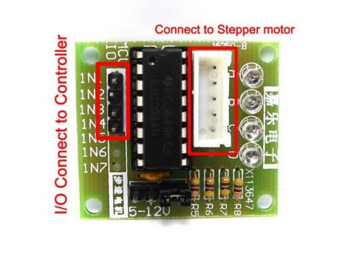

Have a DuinoMite Mega and some ULN2003 stepper motor drivers and a couple of unipolar (five wires) stepper motors from scrapped scanners/printers. Problem is, I'm not sure where to put current on the stepper motor driver, so thought I ask if any of you could help. I attach photo of the driver so you see it.
I suspect i should put either 5v or 12v on either of the terminals labelled so, and leave the unused one jumpered as is, but to afraid to just test it in case it fries my DuinoMite.
(have another DuinoMite still boxed if this one fry)

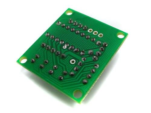

edit: Perhaps the back with all traces are good to include. :)
edit again: sorry, disregard all this, I see now it says 5 to 12v... How embarrassing... Pretty tempted to delete this post now... Well... Edited by mariae71 2012-08-23

Hello Maria,
take a look at:
http://ssecganesh.blogspot.de/2008/05/driving-stepper-motor- using-uln2003.html
Frank
mariae71
Joined: 22/08/2012
Location: Sweden
Posts: 43
Posted: 08:55am 22 Aug 2012
Much thanks for the link Frank,
I managed to get the driver to output signal in the right sequence and the motor to spin, but I think two or more pins between the driver and motor is in wrong place, because motor sometimes misses steps or run a bit jerky... Awesome with the leds on the driver so one can see the sequence... :)
The illustration on the link you provided should be a great help to put wires in right order on the motor. :) Edited by mariae71 2012-08-23

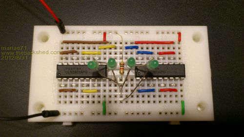

Nice! I ordered a couple of those the other day... :) Also, on a Piezo Driver card from an old broken huge Howtek printer that got slaughtered for rare electronics, I found four ULN2823A, seems to have 8 transistors as well... Other nice stuff on that card is 32 variable resistors, four 10K resistor arrays and four chips called SN74LS24N.
Still planning to test all other suggestions in this thread, I just have to learn a bit more first. I'm very grateful for all help and advice... Thanks! :)
edit: spelling...
edit2: If anyone is interested about what's happened so far... This is a photo of the proto one I made with two ULN2803, with 4 sections in parallel per lead, very satisfied with it, stays room tempered all the time with 12V 650mA, and should handle at least 2A...
Edited by mariae71 2012-09-01
