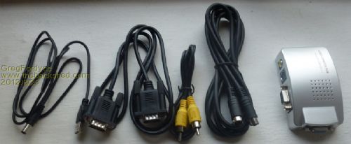

Got the VGA-Video adapter today, very quick delivery! Here's what I got.

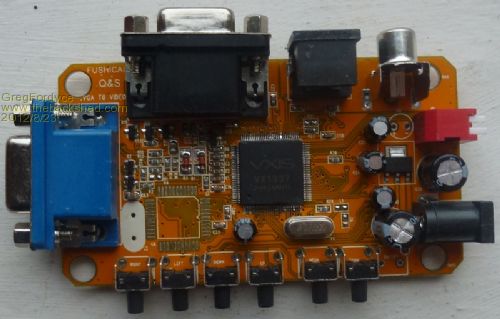

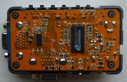

As promised I've opened it up, with the back cover off you see this. The big chip is some SDRAM.
There must be a video encoder chip on the other side, and sure enough;

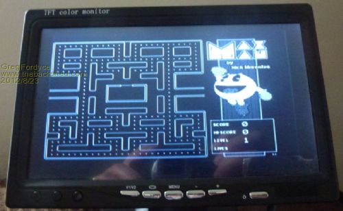

So how's it work? Well I only have an original MM, but here is MAXMAN on a small 7 inch lcd screen.
So it seems to do all I want it to do, and Frank has already said it works with his CMM. I plan on using either large fonts or mode 4 for a user interface so the small size of the standard fonts won't be an issue.

EDIT: the SDRAM is a EtronTech EM636165 and the encoder chip is a VX1937, datasheets availible on google.Edited by Greg Fordyce 2012-08-24
