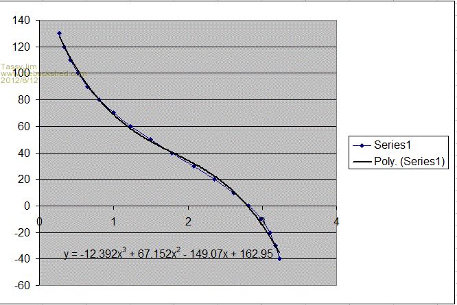

Posted: 02:05pm 11 Aug 2012
The first step is to convert the resistance values into voltages.
With a 1k resistor from 3.3V to the sensor and the other side of the sensor to ground, the table is:
T R V
-40 45313 3.228745709
-30 26114 3.178291657
-20 15462 3.099538331
-10 9397 2.98260075
0 5896 2.821461717
10 3792 2.611352254
20 2500 2.357142857
30 1707 2.080938308
40 1175 1.782758621
50 834 1.500654308
60 596 1.232330827
70 436 1.001949861
80 323 0.805668934
90 243 0.645132743
100 187 0.519882056
110 144 0.415384615
120 113 0.335040431
130 89 0.26969697
I then put this into a chart in Excel and get a trendline.
A third order polynomial gives a close match:
The formula is on the chart.
This is usually close enough given the likely accuracy of the sensor and the MMbasic 10bit ADC.

@Jim
Your table is great and after a little fiddling with Excel i came up
with this Temperature = (-12.392 * (engtemp^3))+(67.152*(engtemp^2))-(149.07*engtemp) + 162.95
This seem to work pretty well.

paceman
Joined: 07/10/2011
Posts: 1329
Posted: 03:36am 12 Aug 2012
Hi Jim,
Good job there.. I wish I knew how to get excell to do those equations and plots (No I dont I will only get myself into trouble)
Mick,
it's pretty straightforward getting EXCEL to do a chart and put a trendline and equation in it. Mind you, I had to do it a lot when I was a worker so maybe that's easy for me to say!
Here's how:
1.Launch EXCEL and put your data into two columns.
2.Put a heading at the top of each column - they'll become the axis headings later.
3.Select the headings and data by left clicking and holding from top left to bottom right of everything you put in, (it'll then be highlighted in blue.)
4.Click on "Insert" up in the toolbar area and select "Chart" in the drop-down box.
5.EXCEL will then automatically place a "Chart" (i.e.graph) on that page of your spreadsheet with your data. You can move it around by clicking in the chart area and moving it when the chart is "tagged".
6.Follow the instructions - the first question is to decide on your type of plot. It'll normally be an X-Y "scatter" plot for our purposes. Click on that and the plain "points only" sub-plot type and it'll display the chart. (Click on the others for fun?? and see what they do - click back on the scatter one when you're ready.)
7.You can change anything, grids, headings, scales etc, either while you're working through the "instructions" or later by right clicking inside the chart area.
8.Click through the rest of the instructions till you "finish" - the graph is then displayed with the points highlighted.
9.To get the calibration equation you need a "Trendline" as they call it. Right click right on top of any point and you should get a dropdown box.
10.Click on "Trendline" in the dropdown box and it'll display the different types of fit you can choose. For us it'll usually be linear, 2nd or 3rd order polynomial or log. Going to a higher order polynomial than third can sometimes give a better fit but the graph might also "turn back" on itself so check what happens to the full range of your input data if you do.
11.Click OK and the trend line is displayed on the graph. To get the equation displayed, right click with the cursor arrow on the trendline and choose "format trendline".
11.The box that comes up will then have an "Options" tab - click that and then click the "display equation on chart" option. OK out and you're there!
NOTE:
a)A common "gotcha" is to have the X & Y axes back to front. Swap them around if necessary and do it again.
b)Most things can be changed, deleted, added etc by right-clicking on them in the chart area.
That all looks not-so-simple but give it a go, it's pretty intuitive once you have the hang of it.
GregEdited by paceman 2012-08-13
