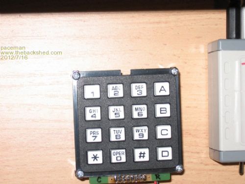

The physical setup is shown below and the keypad is a $29 version from Jaycar (I'm sure there are plenty of others available for a lot less than that though).

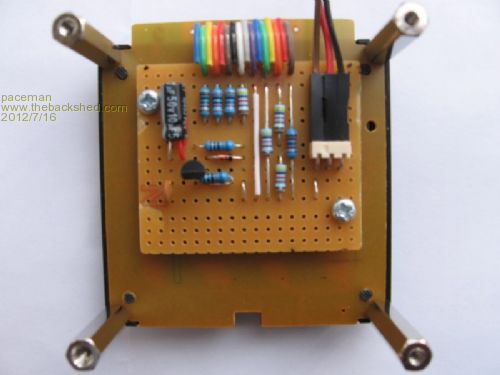

The analogue parts were soldered to a small piece of proto board which can be seen in the second photo. The header holes on the keypad board were connected to the proto board with a short piece of 16 conductor ribbon cable (every second conductor is at 0.1" spacing which gives a neat connection). Ground, 5.0v supply and analogue signal out, were connected using a 3 pin right-angle male polarised connector which is convenient to connect to female jumper wires and then later to a permanent plug for a project. The proto board was attached to the keypad with two short M3 screws which screwed to 5mm lengths of threaded plastic standoff Super-glued to the keypad board.
