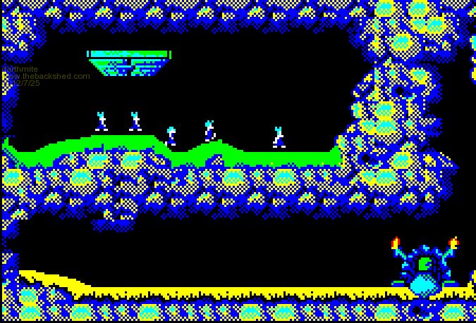

Posted: 01:06am 25 Jul 2012
Heya
The beta test continue !
This time i use bmp ,Sprites , Amiga music modules and ... Blitter
Everything at same time for see if it's stable.
I converted a original Lemmings level for the Maximite and load
it as bmp at start.
I don't have manage to get the real colours but for a test it will be OK
In the video you will see that the screen up down movement is very smooth !
ColourMM test 2
Here a picture.
And here the source code for those who want see how i made the demo.
2012-07-25_110448_SPRITES3.zip
Cheers.
PS : Sorry for my Frenglish language in the video Edited by darthmite 2012-07-26

Posted: 08:54am 25 Jul 2012
Fabulous!
This shows the power of the new MMBASIC in regards to games and what you can do with so little interpretive BASIC code.
The only thing is the flickering of the software sprites. Have you got a delay between the SPRITE ON and OFF commands?
Unfortunately, I haven't got a Colour capable Maximite yet so I can't run any tests but I would look into keeping the SPRITES ON and avoid as much SPRITE OFF time to minimise the flicker.
This may mean, rather than erasing all of the sprites at once, then updating their positions all at once, then finally turning on the sprites all at once... instead, do them one at a time. Each sprite should be turned OFF, moved, then turned ON individually.
I'm only guessing since I haven't looked at your code in detail but this was a problem I mentioned to Geoff when I was explaining to Geoff the operation of the software SPRITE commands.
I can't wait to get my hands on a Colour Maximite!

Posted: 10:47am 25 Jul 2012
I tell this to Geoff too , he will look at new command i have propose to
no more have a flicker sprite.
The thing is that i have to put the sprites off for check if i have a active pixel at left or right from each sprite to decide the direction they have
to run.
Because this is done in the time the sprites are off it take some time that made
the flicker effect.
The new commands i have propose to Geoff are TestPixel(x,y) who return the
pixel color BUT who will ignore it if it is a sprite pixel.
The 2nd command is a Animate command that will automatically draw a sprite from a
animation set.
It's like Sprite Move but for animation .
So , with the normal Sprite Move they are no flicker because the command erase the
sprite and redraw it directly to the new position.
The Testpixel combined to the Animate command can be a easy solution.
Geoff will soon hate me
Each time i send him a mail is for made it work more
And Nick , prepare your MaxMan for colour , it's a must have m8
Cheers.
PS : And don't forget that this is a beta version (who work great) Edited by darthmite 2012-07-26

Posted: 11:34am 25 Jul 2012
Ok. How about this for an idea.
A flag be set when a sprite is written over a background pixel?
It's a difficult problem made more difficult when multiple sprites are on top of each other. How do you identify which pixel is a background pixel and not a pixel from a previously drawn sprite?
This is not a problem on a system with a hardware based sprite system but the Maximite is doing pretty good with this software sprite system. A hardware system also has a collision detection flag to identify when sprites themselves overlap/collide.
Let me give it more thought.
Maybe there is another way to identify the background objects?

Posted: 11:42am 25 Jul 2012
The new sprites system save the background before drawing a sprite.
I think the good way is to check the pixels in this buffer.
I don't know how this background is saved when Sprites overlap each other.
But is something to look at

Posted: 01:01pm 25 Jul 2012
Yes.
I suspect that each sprite has the current background stored prior to drawing the sprite. That means, overlapping sprites will pick up a background with the previous sprite drawn. This will be no good for what you suggested.
I could be wrong, but that was my understanding. It would also mean that the sprites need to be turned off in the reverse order they are drawn. Geoff is the one who will know for sure.
The problem is compounded by the fact that Lemmings utilizes a lot of overlapping sprites and relies on them walking on a jagged landscape.
The flicker is not that bad. Without the sprite command, doing it any other way would create a worst flicker effect.
It's still pretty good for interpretive BASIC with no hardware sprite capability on a single chip computer.
