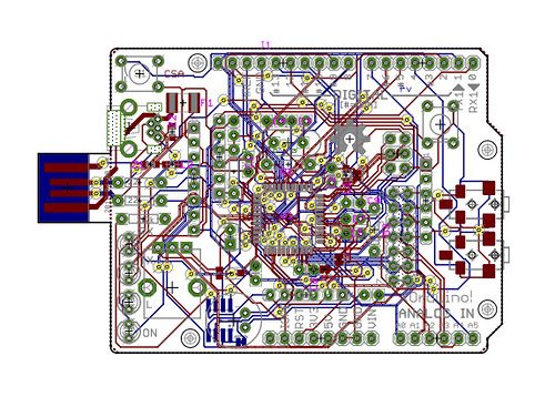

You can read here about it. Is designed to be used with OLPC-XO laptop and the author (Mr. Scott Ananian) claims than it can be easily assembled because it is mainly composed of through hole components.
No way to make this board at home - anyway, it looks like it was routed by the software

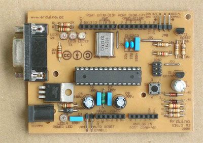

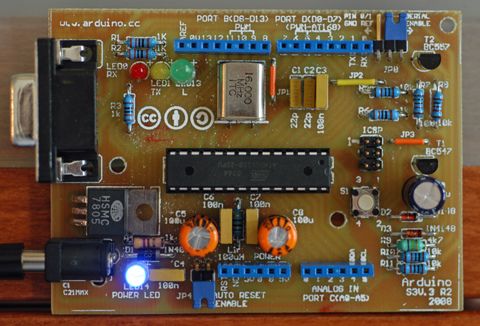

Well, why not building your Arduino compatible board from scratch? There is already Arduino-Severino, a single-sided board, with serial interface.
Didn't knew Mr. Scott Ananian about that? Of course he knew, but you can't make money from that.

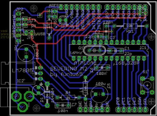

Here is also my design, a little simpler and less components because you will need anyway a USB2Serial adapter (which can be also made with through hole components). The board I designed is intended for those ready to go beyond Arduino language, using avr-gcc and some C libraries. From the production POV is expensive to build a board with THT components than with SMD but, why not providing only the components, letting the children having fun in making their own boards? You don't have to spend money manufacturing something - just send them the components, Mr. Scott.

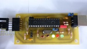

  vasi said   USB2Serial adapter (which can be also made with through hole components).
I'm curious how would you do that?
Every adapter I see has an FTDI chip which are only available in surface mount.
www.elproducts.com
vasi
Joined: 23/03/2007
Location: Romania
Posts: 1697
Posted: 06:13pm 15 Jun 2012
That is simple and at hand of any beginner - the firmware is included in Microchip's Application Library and is starting with PIC18F14K50, 18F2550 and so on. Here is mine (PCB ghetto style, with marker only):

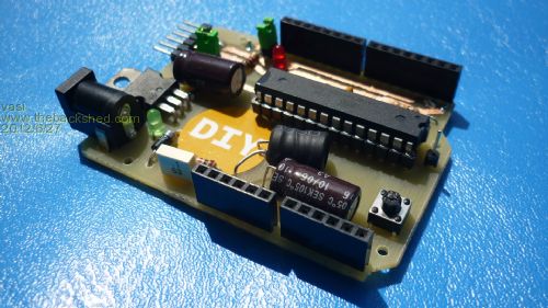

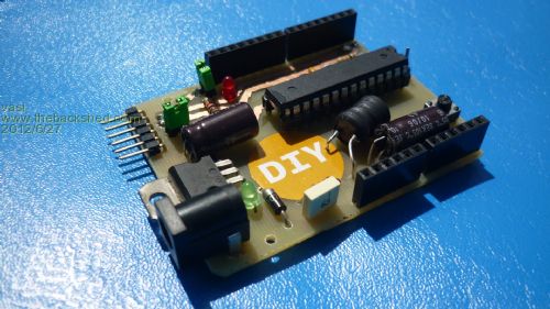

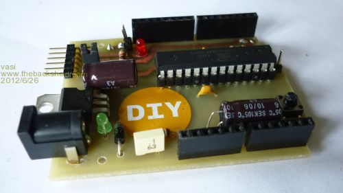

My Severino M2 is ready (ATmega168P). Almost - I don't have the 100uH inductance, can I use one of 220uH?
It will be used for tests with ATmega-CLib project. Eagle files are on Google code.
Edit:
And with the inductance of 220uH.

Just burned the Optiboot bootloader, a hex file from this archive (thanks Calin), optiboot_atmega168p.hex, using an Arduino UNO (thanks Florin) board as here. Of course, first added a new description (useful only to burn the bootloader) to boards.txt file from Arduino IDE as here:
[code] ############################################################ ##
diecimilaP.name=Arduino Diecimila, Duemilanove, or Nano w/ ATmega168P
diecimilaP.upload.protocol=arduino
diecimilaP.upload.maximum_size=14336
diecimilaP.upload.speed=19200
diecimilaP.bootloader.low_fuses=0xff
diecimilaP.bootloader.high_fuses=0xdd
diecimilaP.bootloader.extended_fuses=0x04
diecimilaP.bootloader.path=atmega
diecimilaP.bootloader.file=optiboot_atmega168p.hex
diecimilaP.bootloader.unlock_bits=0x3F
diecimilaP.bootloader.lock_bits=0x0F
diecimilaP.build.mcu=atmega168P
diecimilaP.build.f_cpu=16000000L
diecimilaP.build.core=arduino[/code]
... and moved the "optiboot_atmega168p.hex" file in the hardware/arduino/bootloaders/atmega sub-folder of Arduino IDE main folder.
Reference here - no need to modify avrdude configuration file if you use the latest version of Arduino IDE (1.0.1) - well, is possible to be wrong, I think I use the latest version of avrdude and possibly replaced the original avrdude, not sure...
Successfully tested it blinking the red LED (uploaded the hex file many times after changing the blinking frequency after every upload) using Eclipse IDE. Transfered the program using the USB2Serial adapter based on PIC18F2550. Bootloader is working ok.
Unfortunately, Arduino IDE does not have yet support for ATmega168P but this doesn't matter for me. For those who need Arduino support, just replace the micro with ATmega168 or ATmega328P, the board design is tested.
