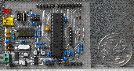

This is a small generic board that might be useful. It has a dsPic
[ dsPic33FJ64GP802, or 128k version ], a basic usb-serial bridge,
power supply and simple analog inputs. The mini-B usb socket is
a bit fiddly, you need a good magnifier to solder it, but otherwise it
is easy enough to work with. It can be used with a simple script
(eg www.hydrazoic.info) or else C and MPLAB/pickit2/3, etc.
cheers all

I have just switched in the PLL with Hydrazoic...
I had to replace the tag tantalum 10uF cap with a lower ESR one,
not surprising... very pleased !!! It is now hitting
half-a-million loops per second. Not bad at all, especially
for a simple board. I'll put more at www.hydrazoic.info
when it settles a bit.

Hi chronic,
Nice board and strange language , thanks for sharing!
How you soldered the IC socket on board?
Vasi
Elvish name: Mablung Miriel
Beyound Arduino Lang
isochronic
Joined: 21/01/2012
Posts: 689
Posted: 03:48pm 21 Jun 2012
Yes the socket is soldered in, the PCB is only single-sided and
so the socket is raised slightly to allow soldering to the copper.
The socket holes can be left undrilled which saves time. Sadly the
socket is not in the component list yet (mea culpa ).
Using BUB3 (eg) for Bit-Up-portB-bit3 is a bit sparse I guess
but the advantage is self-containment on the chip:
the interpreter is 29 kbytes program size,
no compiler needed, no IDE needed, no special cable needed.
In most languages a routine or function is used to set pin bits eg
turnonportpin(3);
even though the value used is not changing.
That is an inefficient use, in this case calling a routine-with-argument
has features and overheads which will be redundant.
cheers
PS Flashing a led (on bit D) at about a Hertz using the "Swift" version:
>main:;;
> BUBD;;
> delay();;
> BDBD;;
> delay();;
> main:;;
> END;;
>delay();;
> FOR a 1,250000 { ;;
> RETN;;
> END;;
A simple led bank can be put on the i/o pins easily enough, I haven't
tried an Arduino led shield though some might run at the 3.3 v.Edited by chronic 2012-06-23
