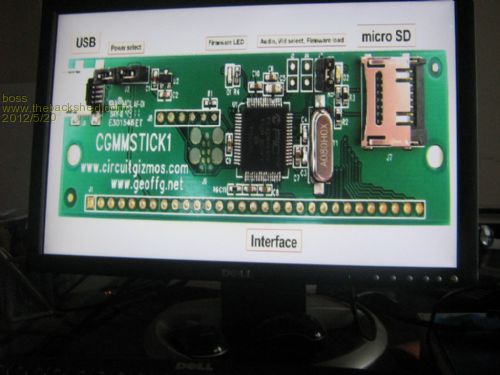

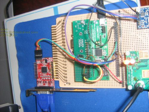

Good day,
and greetings from rainy Vancouver. A board made in Australia can do this. The tiny board costs $49US and is pretty slow, but for industrial control is good enough. It is connected to MM via COM2: and I wish I had higher baud rate then 19200. More info can be found on http://www.4dsystems.com.au/prod.php?id=131. It is able to play .wav files as well (not tested yet). I developed some demonstration SW, so if anyone would like to play with I can send it.

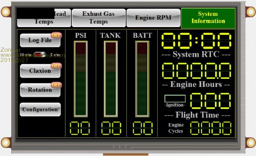

The really cool thing you can do with these displays is setup a small GUI design inside them and then pass value data to the objects inside. I have been using them for an EIS (engine information system) I have been working on.
It has a small screen select bar at the top to show the data readouts of all the information gathered by the Micromite sensor subsystem. Then the MM just transmits updated data values to the 4-D systems display. The display unit handles the user interface... (sweet)..!
