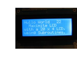

Here is a picture of a 4X20 lcd using the subroutines from the Maximite site, the 22 to the right on the screen is where I was putting the temperature from the information in the previous posts.
Once the lcd is initialised the print routine can be called from anywhere within the program.
very happy.
regards
cliff
