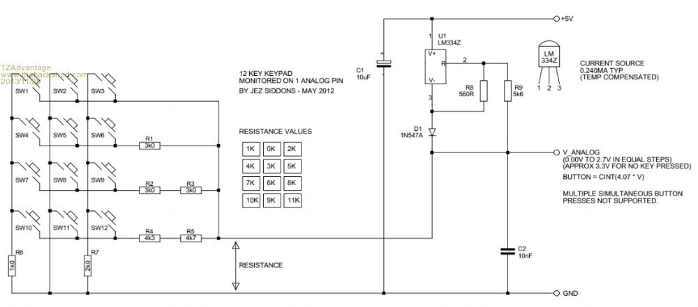

Has anyone got the original schematic for the 4 x 3 to 1 wire adc? The links are not responding and I really need this keypad platform to work.
Cheers Guys
Stewart
Red to red, black to black and blue to bits!
Posted: 05:54am 29 Nov 2013
Here you go:
bfgstew
Joined: 27/04/2013
Posts: 19
Posted: 06:01am 29 Nov 2013
Many thanks TZ, much appreciated

  TZAdvantage said   Here you go:
Sorry Stewart, I received your messages in the middle of the night our time, so I couldn't respond.
I will reference my article to this thread, as the old Ken Segler site is up and down like the proverbial.
Thanks TZAdvantage for coming to the rescue.
Cheers Don...

Sparkfun now sells VKey Voltage Keypad 3x4 as part PRT-12080. It uses a constant current source and user comments discuss temperature effects.
