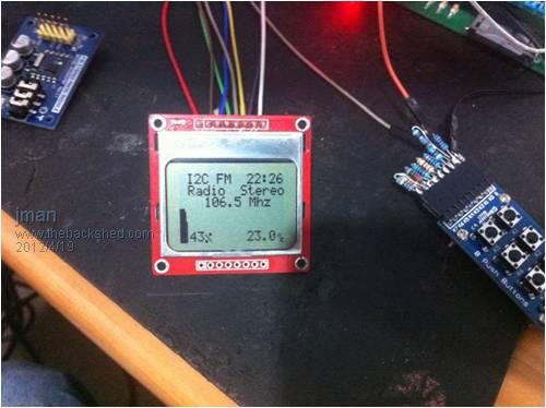

This my implementation of the I2C based FM radio found on ebay
Ebay I2C Radio Kindly shipped to me by CrackerJack (Thanks Rob)
The software use's the Maximites different I/O types
I2C is used for the Radio and the RTC(PCF8563)
SPI is used for the display (Nokia 5110)
1Wire is used for the temperature DS18B20)
Analog is used for the 8 buttons (Resistor voltage divider)
The code is attached it is by no means neat and tidy
The fonts and the graphics for the LCD are loaded from the SD card (B: Drive)
The saved stations are saved and loaded on the A: drive
If the preset.dat file is missing one will be created
I have started to update the code to use MMBasic 3.2
so this is the required version
The Radio has the following feature's
Volume Up / Down
Seek Up / Down
Stereo / Mono display
Signal level indicator (Graphic and alphanumeric)
Store Recall up to 10 presets
Mute
Loudness (Bass)
Temperature Display
Real Time Clock
Youtube video
