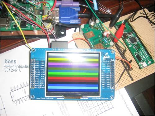

Good morning,
one of the major disadvantages of the MaxiMite is an absence of the color display. This can be easily solved without any additional hardware, just by using a 4-wire SPI and one pin for RESET. I found one on eBay 3.5" TFT LCD 320x240/262k color controlled by SSD2119 chip which allows SPI communication. Yes, it is slow beause the INTERPRETER is slow and SPI runs at only 500kHz, but the chip itself supports up to 15Mhz SPI clock. A larger display, such as 4.3", has a resolution of 480x272, which is close to Maximite VGA but uses a parallel 16bit interface. This can be easily done with two 595 chips and a few MM pins (WR,CS and RESET). The code is not included because it is still very rough and buggy, but if someone is interested, I can send it. I think that the final solution probably should be written in C, as MM Basic command, or as a Library. The SPI command has to be modified as well.
BTW. price for TFT is starginf from $35. http://www.ebay.ca/itm/120784266134?_trksid=p5197.c0.m619

H2012-04-16_053811_LCD_TFT.zip
Here is the requested code and source where I learned what to do. Again the code is not nice, don't blame me. I started just yesterday and there is a lot to do. But it is working.
