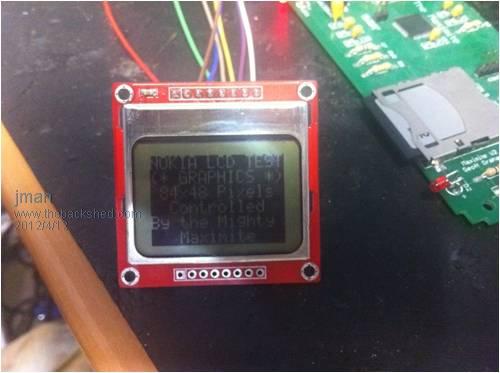

Hi
I was playing with a Nokia 5110 LCD and SPI
These displays are graphic with 84x48 Pixels
So we need to create our own fonts in software(But the displays are real cheap)
Ebay 5110 LCD
Code attached
2012-04-12_174610_NLCDv1.zip

  jman said   Hi
Great Work John,
Can you post the hardware connections as well?

Sure
The LCd is wired as follows
Maximite Pin Nokia LCD
Pin 1 = Pin3(SCE)
Pin 2 SPI TX = Pin6(DN/MOSI)
Pin 3 SPI CLK = Pin7(SCLK)
Pin 4 = Pin4(RST)
Pin 5 = Pin5(D\C)
Pin 6 SPI RX Unused
Attached is an improved version with all the DATA statements removed
The fonts now load from the SD Card.
To use copy the included fonts.dat to your B: Drive
This has made the program memory use much better 9% VS 27%
2012-04-13_161903_NLCDv2.zip
