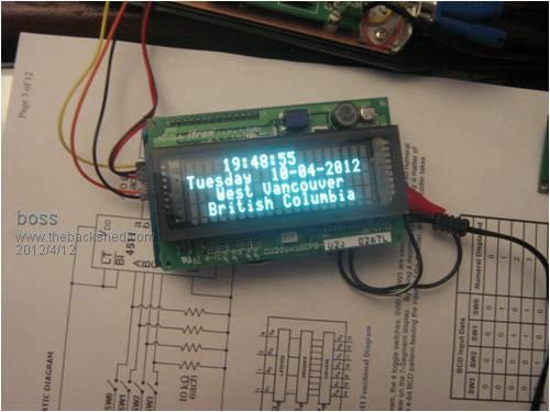

to save precious Maximite pins in my aplication I connected LCD (or VFD) display via SPI (3 wire connection)
2012-04-12_022125_LCD.zip

That is so neat... only 3 pins to control a lot of output.

and you can concatenate these chips to get as much pins as needed for price 30c/chip include shipping on eBay.

where can i get this display module ?

Noritake-ITron VFD modules are available at
Element 14 (Farnell) although they are a lot more expensive ($70usd or greater)than
the LCD character displays (From $3Usd) or LCD Panels/Displays (from $20).

From time to time these displays are on eBay. And sometimes for very reasonable price. Personally I liked VFD much more than LCD.
