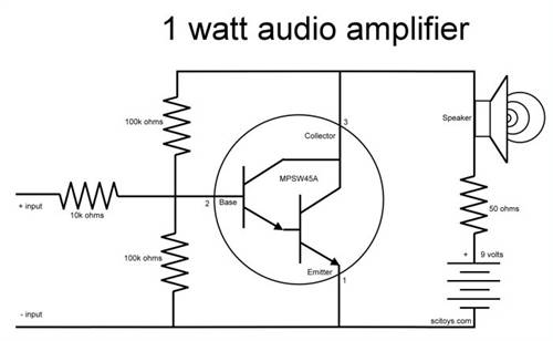

I have a recordable message card, with a 0.5watt external speaker that I wish to increase the volume on.
I found a 1 watt , 1 transistor amp on the net..
http://sci-toys.com/scitoys/scitoys/computers/solderless/amp lifier.html
My question..
Will this amp blow the speaker? and I need to get a better speaker.
or if I change the 100 ohm resistor to 50 ohm then speaker will survive.
[edit] Schematic has 50 ohm, but project was built with 100 ohm [edit]

Should work ok with existing speaker.
Although the LM386 AMP project would be a better design.
LM386 Based Audio Amp kits are everywhere on Net for little money.
Pre-Assembled LM386 AMP Module $8Edited by djuqa 2012-04-09

That was the next project from the sci-toys website, and would use less power. as the device would be powered by battery's , that would be more desireable..
with the added bonus of adjusting the gain and sending the bass signal back for re-amplification.
