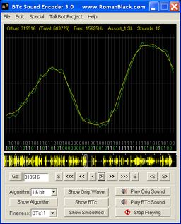

I tried the excellent BTC Sound Encoder 3.0 software
free on site http://www.romanblack.com/picsound.htm
I used 1.7 because the algorithm 'is the best
speed on Maximite.
See BTC Sound Compression Algorithm http://www.romanblack.com/btc_alg.htm

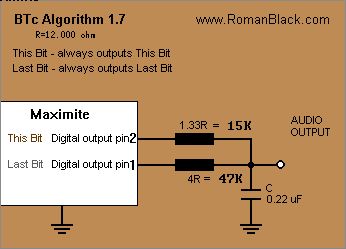

I used two resistors and a capacitor to pins 1 and 2 of Maximite. Something feels ....
I could put a LM358 to increase the volume.
Examples:
10 ' Playback sound with BTC encoder 1.7 - PIU' VELOCE
12 ' New Bit Pin -> resistor value 1.33R -> is always output = 15k
14 ' Last Bit Pin -> resistor value 4R -> is always output = 47k

Wow, this looks great Raros, I'll be building this circuit tomorrow and trying it out. Cannot wait.

Raros, your idea above is brilliant . I will try this out when I have some time
