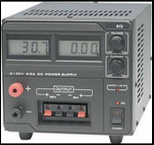

I looked up your Manson supply. All I can say is wow. I found it for sale at about 80 EUR. Here is the manual for it and a picture.
If I was doing what you are doing and had the Manson, I would use the Manson as the breadboard supply as its adjustable supply has adjustable current limiting also. This leaves the question of how to power the MM.
Altronics offer the plug pack M9237A and Jaycar offer this plug pack MP3310 . I prefer (and use) the Altronics one as it is more foolproof. The Jaycar one is multi voltage and if used incorrectly could cause trouble.
From the Manson manual:
The grounding of the output terminals is independent so that the output
can be connected in series to make a higher output voltage.

  BobD said   Greg
Having said all that I am going to leave your questions to Mick.
Hi Bob,
I bought it at Radio Spares about 6 months ago for $99 - probably not that good but not too bad either. I'd decided I wanted to get into electronics a bit more and would need a reasonable supply. Would you believe I already had a hardcopy of the Manual(which I did read originally) but I remember that I'd decided at the time that it was pretty minimal (more a safety manual) and I filed it away and forgot it!
Re the current limiting - yes I'm sure you're right about it being handy for the breadboard etc but I thought I'd still need the +/- 9,12,15v that Geoff's design gives so I decided I'd build that too (partly for fun as well). That then meant I'd have two good power supplies in front of me but the Manson was the one with the big-ish +9v supply (via the main adjustable supply). I did power the MM for a while with a plug-pack but then decided I'd be wimping out by not using one of my "proper supplies" once I'd finished the "Utility" supply! Hence my questions on this thread.
