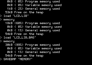

I ran out of program memory.
The screen capture above shows that the incomplete library takes 18kB or 60% of program memory.
The library and its supporting test code takes 30kB or 99% of program memory.
I've attached the code. It tests OK for 4x20 LCD screens so far, but doesn't have some of the functions implemented yet.

I followed djuqa's suggestion and converted string parameters to numeric, and I wrote a short program to strip out blank lines and remarks. Now I have a fully commented source program for developing the library, and a stripped down version for distribution.
Memory usage for the library dropped from 18kb (60%) to 6kb (20%). The lesson is that libraries (not individual subs) may have to do without comments so there is space for users to fit in their own programs, but there will have to be good supporting documentation.
