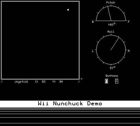

Hi all,
After playing about with the Wii Nunchuck and Maximite for some time, I have put together a program which I believe demonstrates most of the capabilities of the Wii Nunchuck and the ease with which the device can be used as an interface to the Maximite. I expect that this code could be used with a Duinomite, but I have not tried it. My DM is currently a MM in disguise of 3.1; also the demo code assumes VGA use.
The code listing is included at the end of this post (for your reading pleasure) and also in an attached ZIP file should you want to try it out at home. A screengrab follows with some explanatory notes. The usual "this is free; and I accept no liability for anything you may do to yourself or anybody else, what you may break, or set on fire as a result of your use or abuse of this code, etc." clause applies.

The code is necessarily a bit heavy on the Trigonometry side. This is because unlike previous code seen for the Maximite using the Wii, the values coming back from the accelerometer are not just displayed as raw values, but actually degrees of Roll and Pitch. A full 360 degrees of Roll is provided, and almost 180 degrees of Pitch. The Wii Nunchuck does not really have a useable Yaw axis, but the other two axes, the button states and the joystick values and position are shown visually in the demo. Also, the direction of the Joystick (rather than position, and which may be useful for some implementations such as games, etc.) is shown by arrows at the top and right edges of the Joystick "zone". Using dedicated fonts for these arrows instead of < > ^ and v ASCII characters would have been nice, but you get the idea....
Since the Maximite does not have a full suite of Inverse Trig. functions, two of these (ACOS and ATAN2) are implemented as Sub's. ATAN2 is of particular interest in this application because it is used to find direction (ATAN cannot be used for this purpose).
There are some constants used in the code which may vary between Nunchucks. I have three and there was little variation between them, but you may want to experiment.
To calibrate the Joystick, push both the C and Z buttons at once while leaving the Joystick in it's neutral position.

Hi Rod,
I guess I used a little bit if license in my usage of defined Sub's and variable names to make things more resemble what Geoff has indicated is coming in 3.2
The way it works is (using ATan2 as an example):
The variable ATan2 is first used in the Sub of the same name and is by default a Global variable. After a call is made to the sub - the interpreter identifies it as a call to a sub by the following space and left bracket - the variable now holds the value which is then used as per normal (without a space and left bracket following, so the interpreter knows it is just a variable not a Sub call). Hope that makes sense.
I suspect things will be more simple in the next version of MMBasic.
