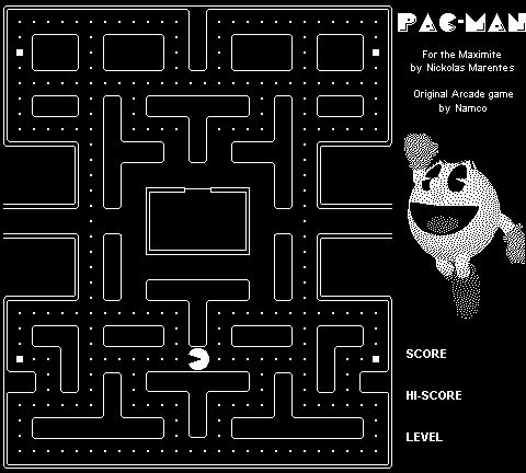

Below is an image of what I have done so far. The PACMAN character can navigate all around the maze and eat all the dots. The speed and animation (mouth chomping) is just like the original arcade game and the use of an interrupt holds the game at a consistent speed.
The game is fast enough so that if I turn off the speed control, the PACMAN moves around the maze as a blur, indicating there is plenty of time left to add the 4 ghosts on the screen and keep a speed that is very close to the original and operating just as smoothly.
This is a work-in-progress and I will keep this subject thread up-to-date with my progress.

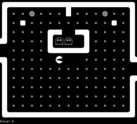

You are going to beat me to it too, I stopped to write BASIC addons and have left my 70% done pacman lay dormant for weeks :-)
This is an old screen shot, it's come a long way since and a ghost is slowly learning to chase me around with sound effects.

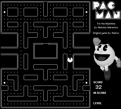

Today's update includes a few minor "cosmetic" changes to the graphics, mainly the title text.
I have it now accurately keeping track and registering all 244 pellets being "eaten" (240 normal, 4 power pellets).
The warp tubes at the left and right side of the game screen operate and the score indicator is functioning. I have set the pellets to only score 1 point so as to act as a pellet counter for testing purposes.
Have been running around the maze checking the keyboard response and looking for bugs. So far, so good. Speed is good but will later provide speed enhancements by changing some of the goto's to labels.
Just about ready for the next big challenge, the 4 ghosts!!
