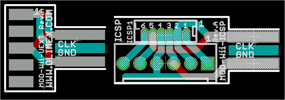

Olimex
Joined: 02/10/2011
Location: Bulgaria
Posts: 226
Posted: 05:48am 30 Jan 2012
just to tell you that we have Wii to UEXT connector prototype
it's very easy to do it look Here we just add UEXT connector on it, now Don suggested us to add ICSP connector layout too so we can use ICSP connector as joystick connector

Olimex
Joined: 02/10/2011
Location: Bulgaria
Posts: 226
Posted: 10:01am 30 Jan 2012
here are two adapters one for UEXT one for ICSP
I will add functions for them in the firmware, what do you think for these:
Wii.aX Wii.aY Wii.aZ return the accelerometer X,Y,Z values
Wii.but returns number bit 0 = button1 and bit 1 = button2 status
Wii.x Wii.y return X,Y joystick values
