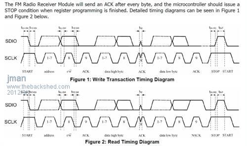

The timming is as this pic

Jman, just had a brief look so I may be way off the mark, but is there not a bit of confusion in your program between bits and bytes? You are reading into a buffer of 8 bytes and then iterating over those bytes in the debug loop. Should you not be reading two bytes High and Low and then dealing with the bits as per the register?
jman
Joined: 12/06/2011
Posts: 711
Posted: 06:08pm 01 Mar 2012
CrackerJack
Thats the problem you are a winner
