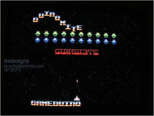

Video is not that great quality
This is a DuinoMite Mega with a GameDuino shield
Ken
Youtube Video
code is a mess but was just for testing
