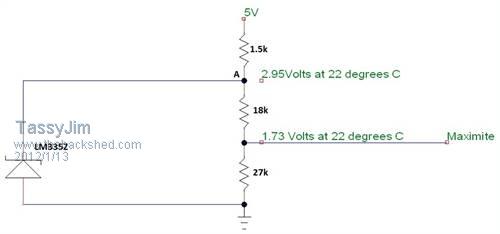

This is my circuit
I have put a 0.01uF capacitor from point A to ground on some of the long leads.
To get the scaling factors, I measured the Maximite voltage at a known temperature and calculated it from there.

I like the way you got your circuits set up for each LM335. Is the av(3), av(4) the average of the pin(x), etc voltages you collect directly from the Maxmimite pins that the sensors are located on? This looks great.
So you average the pin voltage readings for five minutes for each individual pin, putting the results into av(x), av(y), etc, and then at five minute intervals you use scaled(x), scaled(y), etc to convert the averaged voltages collected to display the results?
I like that if I understand correctly. Could you share a couple lines of code showing how you collect and average the pin voltages on each program loop?
I am new to circuit board building and have never learned about or understood capacitors before. I do have a box of capacitors, mostly disc types with a few cans. Wikipedia tells me the small disc types are rated in pF. So if I need to use a .01 uF isn’t that the same as 10 nF or 1000pF? I’m trying to see if I have what I need to jump these four sensors pins to ground. I’m not sure I understand how to read their markings. Guess I need to order up a collection of capacitors. Do you suggest cans, disc, or ceramic? Do I need all three for amateur work like this? Are the .01uF caps that I need most likely to be disc type?

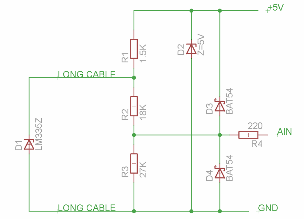

for industrial environment with lot of noise and long cable I would modify TassyJim schematic to this:
I've seen hundreds of volts induced picups on long cables going near motors and relays

Okay, I will add resistors R2 & R3 and recalculate based on the resistors true resistance as measured using a meter.
I'm currently using 1.8K resistors for R1. Do I need to change them for 1.5K resistors or can I leave them as 1.8K? Will these 1.8K resistors affect the voltage divider formula? I don't see how they would, but I am not schooled in these matters.
The formula I will use to calculate the Pin(1) multiplyer is: 100/(R3/(R2+R3))
If R2 is 18K and R3 is 27K the result should be about 166.7, but should be adjusted for the actual values of the resistors. If I understand correctly then the degree Celsius reading would be Pin(1)*166.7-273.
Some of this was taken from Olimex's blog and repeated here for the benefit of those who didn't follow the link. Thank you Olimex
So folks, do I need to swap the R1 1.8K resistors for 1.5K resistors?
