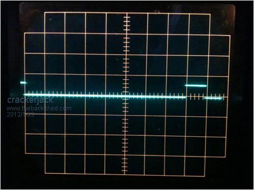

Now that in 3.1 we have the PULSE command, controlling of servos from any pin might just be a snap, right?
[code]
SetPin 1,8
period=20
position=2
Pulse 1, position
Pause 20 - position
Loop
[/code]
The above should hold a serve in it's Max position.
Obviously the code above is only an example of generating a demo servo signal where position is varable between ~1 and ~2 mS.
I have no servo at hand to try this out, but I'd be keen to see if this works.
See the output on the scope as attached (5 V/DIV, 2 mS/DIV)
Cheers,
CrackerJack.
