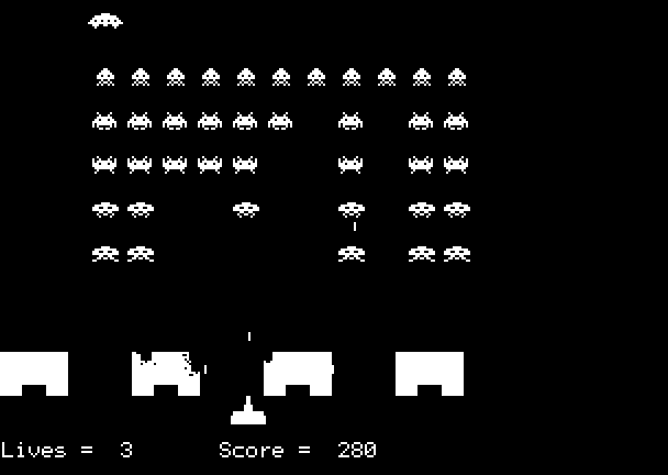

Hi ,
This morning i have want some fun ,
then i program me a little Space Invaders
No Mistery ship and Bunkers atm .. but it's playable.
I have use AniMite to create the Invaders sprites.
they are 3 buttons:
PIN 13 : Left
PIN 14 : Right
PIN 15 : Fire
Enjoy

Hi again ,
I have made some improvements in the game.
And now we have the Mistery ship too ...
2012-01-03_023728_INVADERS.zip

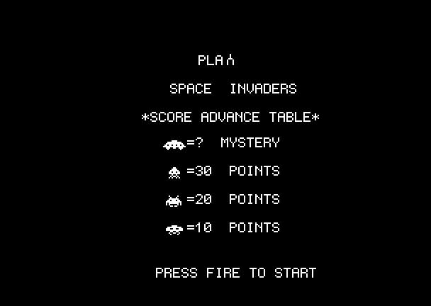

He he , i was sure someone will found this cool
I made all other needed improvements.
bunkers are here , and the menu screen is
most like the original one
2012-01-03_075258_Invaders.zip

also I noted that the invader on the start screen comes out 1 line above where the upside down 'Y' in PLAY is. This is intentional? If so ignore my fix..
if not I changed the code on lines
6200 Line (px1 , 38) - (px2 , 49) , 0 , BF
6210 pause 5
6220 locate AnimX , 38 : print CHR$(Spr);
Changed 38 to 50 and 49 to 61
also on lines
6370 & 6390 , 6490 , 6520 & 6540, 6680 & 6700 and 6760

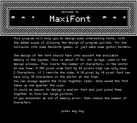

I wrote a Font editor, Called it 'MaxiFont' that I have sent to Geoff, for the library. So if you want, you can pick my programming errors..
Link to MaxiFont http://members.iinet.net.au/~dpwyatt/MAXIFONT.zip
I too created an invade.fnt
As I said before, great implementation, well done
Keep plugging away, it is fun learning
But can be expensive (if you keep blowing things up).

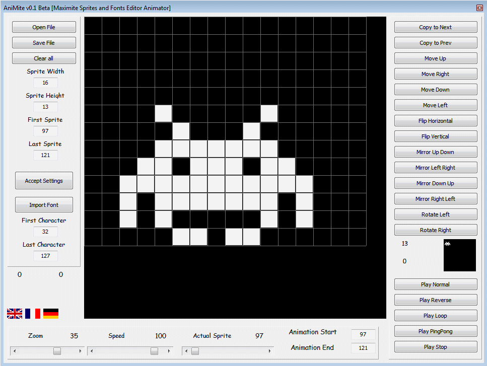

Heya Wombat,
Do you have see this one ? :
Animite
for the change on the line 6200 to 6750 it can be that we
get a difference between Composite PAL and VGA.
Here i use the PAL connection to the TV.

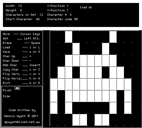

I haven't actually seen this editor before, but it looks awesome.
My font editor is written on the maximite for the maximite..
Screen 1
screen 2
But yours looks better( color )
Hasn't been tested on a composite display....
Edited by MM_Wombat 2012-01-04

Bah ! ,
It just look better because it's done on windows ,
Your have give you more fun to write because it's directly in MM Basic
I never have write any game on windows but i want made allot on MM ...
In the next future i will probably add the VGA connector to my DIY maximite
so i can see if my soft work in all possible configuration.
Anyway your MaxiFont will be a good add-on in the MM Library
Cheers.
Darth.

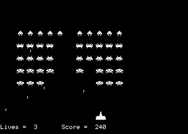

Hello
Today i have optimize the Invaders game code.
It's more readable now , and the game is faster too.
Now each level is harder with faster Invaders and
more of them are able to shoot when the next level
start.
I have found why it was different in start screen between composite
video and VGA.
That was just the 'Press fire to start' who was to low on screen and
then moved everything up ;)
So ... enough babbling ... here it is ...
2012-01-05_053029_Invaders.zip
I hope you will enjoy
