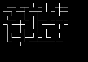

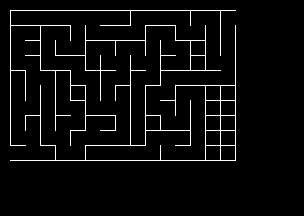

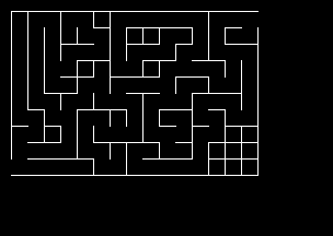

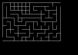

This time i made a little Labyrinth generator , it's not actually perfect because
i get some unsolvable Laby but it can be a base to some who want made a Labyrinth
style game.
Here are some pics:
and here the source:

You can change the Width and Height here:
50 Labwidth = 15
60 Labheight = 10
If someone correct it to made a generator who create 100% solvable Laby
each time , please post the source here.
Cheer.
