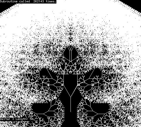

Screenshot of another.
Image is Delta 3, Length 50, turtlespeed = 0, 194s to draw.
