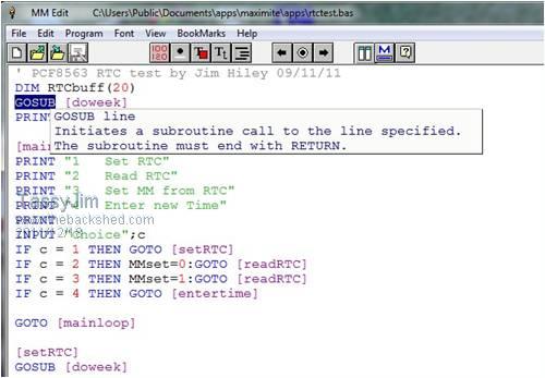

MM Edit is now in colour.
You can now have
Colour syntax highlighting
Uppercase keywords
White space markers (help solve text alignment issues)
Bookmarks and pop-up help.
The Help files can be edited to cater for new commands or errors.

Posted: 10:45am 18 Dec 2011
The popup help especially is impressive.
Can you copy / paste from the pop-up help window? What I'm thinking is there could be sample examples of the use of the instruction from where a copy/paste could be performed down into the code being written.

Keith I don't know if you have Jim's MM Edit program running but from what your suggesting it seems to relate to the program MMIDE which I believe is a different program by CircuitGizmos albeit a good source of a command help file.
Jim's screen image above shows the help info in MM Edit itself.

Posted: 08:42pm 18 Dec 2011
Ray,
To get the help you need to highlight the keyword rather than hover the mouse.
I did try hovering but the code was too unwieldy.
GOSUM sounds like a DM command and I have not done any DM specific code yet.
Or did you mean GOSUB?
The F1 key usually works but when you have one of the communications winds open it interferes with things so it is sometimes disabled.

Posted: 02:55am 19 Dec 2011
  Ray B said
Re the contents of the Syntax Help pop up box where is the definition of the string being looked up being defined to the contents of the pop up box stored. Specifically can a user directly access / edit / add to this lookup table.
From the help file:
/quote
MM Edit Version 1.5 Page 6 of 11
The Syntax help file can be edited and new commands can be added.
The files are located in the data directory which can be located by selecting 'About'
from the Help menu.
MMcmndlist.dat is the Maximite Command list.
DMcmndlist.dat is the Duinomite Command list.
The commands do not have to be in alphabetical order.
Some commands are added as part names as well as in full to allow highlighting as
you type. Eg 'LEFT LEFT$ LEFT$('
MMsyntaxhelp.dat is the Maximite Help file.
DMsyntaxhelp.dat is the Duinomite Help file.
Each entry consists of 5 or more lines
ABS(
ABS( number )
Returns the absolute value of 'number'.
ABS(-6) will return 6.
The first line must be '###'
The second line is the keyword.
When searching the list of keywords, MMedit will also accept part words.
'ABS' and 'ABS(' both bring up the 'ABS(' help. This makes highlighting
words/commands easier.
The 3rd line is currently blank. Future versions will use this line as an index to a more detailed Help file.
The following lines are for the help text.
Correct syntax is usually the first line and the remaining lines are for examples.
This format doesn't suit some commands so (almost) anything goes.
At the time of writing, both versions are the same but users can edit the files to allow for differences.
/end quote
I suggest you make a copy first or use the DM list to play with.
To test your changes, simply change from Maximite to Duinomite Syntax and back in the View menu to cause the program to read the new/altered file.
