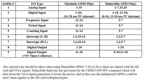

There appears to be a problem with the GPIO chart in the manual (3.7.GPIO Chapter page 19)
Geoff refers to CI as available on MMBasic PIN(11),(12),(13),(14) which are pins 4,6,8,10 on the 26way header.
The diagram on page 18 shows these as Arduino DO,D1,D2,D3 against PIN (11),(12),(13),(14)
so far so good
Now back to page 19
and MMBasic PIN(11),(12),(13),(14) are against Arduino D0,D1,D2,D3 and 26 way header pins 4,6,8,10 which appears to be the correct configuration.
BUT the listing shows MMBasic Reference PIN(5),(6),(7) as being CI on the 26 way header pins 13,11,9 against Arduino A4,A5,D10 ??? and one of the CI pins is not even referenced ???

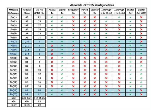

I have just done a table for Tsvetan to consider putting in the next manual, it may make that area a bit clearer, (It may not display well on the forum but if you PM me I can email it to you (full size about 1Meg)
Let me know what you think.
DuinoMiteMegaAn
Joined: 17/11/2011
Posts: 231
Posted: 10:56am 17 Dec 2011
I went several steps further by including all the 5 volt tolerant pins, the explicit name descriptions/functions and whether the pins are shared or not with the other I/O connectors.
2011-12-17_205613_DuinoMiteMega_Input_Output_R3.pdf

Ok The charts make it clearer. I had worked out correctly then so I will now copy what happens when I try to setpin 5 to counting.
> list
10 SETPIN 5,5
20 PRINT pin (5)
30 PAUSE 1000
40 GOTO 20
> run
Error line 10: Invalid configuration value
but using pin 11 or 12,13,14,15 is accepted
Bug in firmware ?? or am I incorrect still
Herb Edited by herbnz 2011-12-19

Your chart differs in some areas to Mine, I need to consult Ken and Tsvetan for clarity on these...
I garnered the data from the Manual, so there could be an error there.. I also have added a +5V tolerant column and that also differs (info from manual) from yours, I have also been asked to put the CPU Pin Numbers/names into the table and am considering this but dont wish to make it more complicated than it needs to be...
I got the info from the Olimex web site. I assume it is one created by Tsvetan.
The confusion is really being created by the MMBasic split into a number of different streams (MaxiMite, UBW32, Olimex). The only commonality being the PIC32 MCU and even then there is probably the 64 pin and 100 pin versions (I haven't checked this as the code is now being distributed in hex only).
Evolution in action ... exciting times ... exciting challenges.

Herb
Firmware 2.7a is a MaxiMite version.
Duinomite is at version 2.7 and should be downloaded from Olimex or Dontronics. I note that both websites are saying that there is currently no support for PIN() ?? not sure if this also includes PIN(pin) see Commands listing.
Also I just noticed in an earlier post you used 20 PRINT pin (5) this should be PIN(5) ... no spaces and upper case
Also try a different square wave or whatever it is you are trying to count ... even a switch with 3.3v should produce a rising positive leading edge. OR use the following code from the Olimex Duinomite Manual to check an alternative arrangement for the pin before trying the CI.
