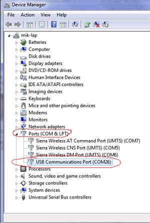

Posts: 2984
Posted: 03:08am 14 Dec 2011
  BobD said
Don, MMIDE does select COM3
.... Bob
Hi Bob,
Maybe COM3 is used as an internal device....
Try setting to a port thats higher (mine sets to com26)
Go into Control Panel --- Device Manager ---- Ports ----

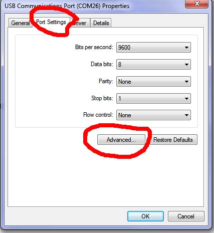

Do Properties on the relevent USB COmmunication Port and click advanced and select a port that it says is available (i.e. NOT in USE)
Also check that the Port settings are
Baud 9600
Bits 8
Parity N
Stop 1
FLow None
in the section just before you click `advanced'

Posts: 2984
Posted: 05:58am 14 Dec 2011
  BobD said   bigmik
I would suspect that you don't have Win 7. My systems don't quite follow your description. There is no list of ports with their status. I did try selecting other ports, some said they were in use and others allowed me to use them. I checked the port settings and they agreed with what you advised.
I wasn't able to get success with any port I was able to select.
I'll have to leave this until next week as I will be in Melbourne until Monday.
thanks .... Bob
Hi Bob,
I do Indeed have WIn 7, home Premium, 3 systems running it.
I did skip a couple of steps though... sorry
when you see the list of ports as in this picture
Then right click on the port Number to get properties and click the key card tab to select Port Settings as shown,
The port settings are there and the advanced tab near the bottom

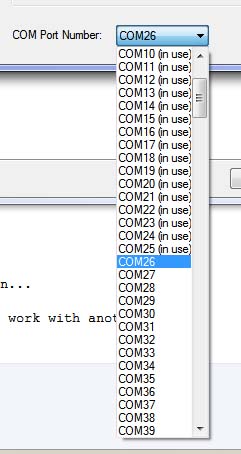

when you put it in pictures then yes we do see the same thing. I did not interpret your explanation the way that you intended.
Many ports not listed as in your first image were In Use and unavailable. Finding available ports was trial and error, mostly error. Any available ones I tried did not work.
Ok, Bob,
When I select a port to assign, Using advanced TAB under port settings, I get the following and it lists all available Port No's I can use
If you selected one that doesnt say `in Use' then sorry, I have no idea what it could be then...
Have you tried another Maxi on that PC? Does it work with another Maxi?

Posted: 06:46am 14 Dec 2011
Ok, we did see the same thing but none of the ports in my list were showing as (in use) so that confused me. Anyway, I just forced a port change to 16 and now I get complaints from the system that the port can't be installed. I'll reboot and try again.
