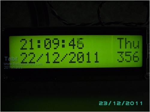

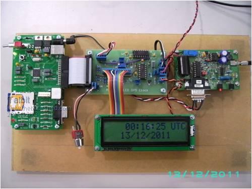

This is the latest version of my GPS Clock. Please refer to my original post on 26 September for more info on the concept.

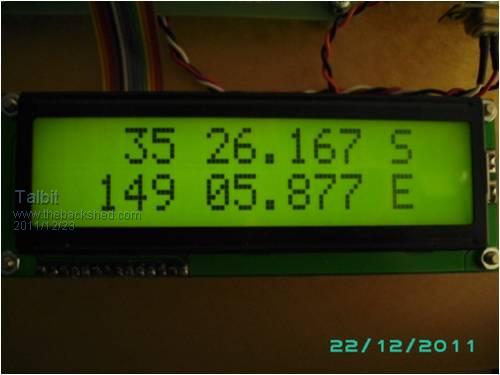

The main improvement is the addition of a push button which gives a display of the position.
The clock uses a Trimble ACE 3 module set to deliver the NMEA string at 19200, 8, N, 1.
The LCD routine is unchanged from Geoff's original code. It also uses his parsing code to extract the relevant information from the NMEA string.
Thanks to all who contributed help on my code hang-ups!
I’ve also attached a circuit diagram and have built the PCB.
It works like a charm.
Not that the Alarm (Time Break) now appears on pin 2 and not 18 as in the original design.
Pin 18 now controls the PPS LED. It only enables the LED when there is a valid GPS time and position fix.
Please post any suggestions or comments.

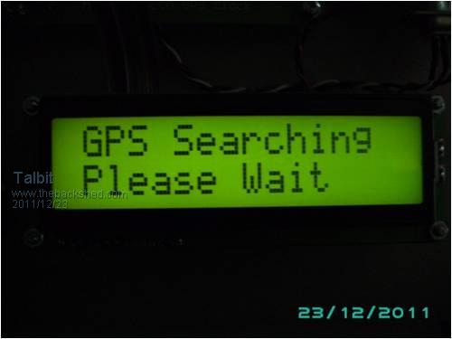

275 PIN(18)=0 ' Switch off PPS LED
280 LCD_line1$ = " GPS Searching "
290 LCD_line2$ = " Please Wait "
295 GOSUB 12000 ' Send message to LCD

Posted: 12:06pm 20 Dec 2011
Thanks to tassyjim's very smart code to extract the day of the week and the day of the year, I've been able to add these features to my GPS clock.
It now gives this display...
12:05:37 Tue
20/12/2011 354
and the Latitude and Longitude when you press the button.
I'll test it for a few days then post the code.
Thank you Tassyjim !!!

Joined: 07/06/2011
Posts: 210
Posted: 09:34pm 22 Dec 2011
Here you go, just in time for Christmas !!!
The new code gives UTC Time, Date, Position, Day of Year and Day of Week. Also a couple of happy snaps to show the three readouts.
Thanks to Geoff Graham and Tassyjim.
Talbit
Merry Christmas.
ps Now you know where I live!

260 PIN(18)=0 ' Switch off PPS LED
270 LCD_line1$ = " GPS Searching "
280 LCD_line2$ = " Please Wait "
290 GOSUB 12000 ' Send message to LCD
