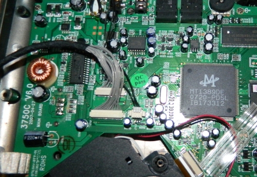

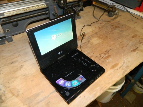

I dug up an old DVD player that was given to me because it stopped playing DVD's.
The display worked, so I opened it up to see if I could separate the screen from the rest of the unit. No luck, the video controller is part of the main circuit board.
But the unit does have a video input, so I wired in a cable to connect it to a SM1 Maximite set to PAL output. The screen swivels around and folds down, cool, but when I power it up, I need to press several buttons in sequence to select external video source, bummer. It will do for testing.
I'll look into those reversing camera screens. I hope their current draw isn't too much, as I would prefer to leave the screen turned on all the time.

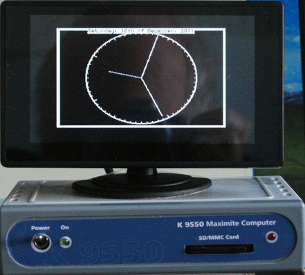

Posted: 11:32pm 10 Dec 2011
My 4.3 inch monitor is a CZ7 model.
Current draw when displaying is 124mA from 13V
68mA when no input.
Pete, If you are running long distances and multiple monitors you might need to install a video amplifier.
I think the monitors come in NTSC or PAL depending on where you live. Mine is PAL.
They are also wide screen so you either loose some screen area by running in 4x3 mode or have a stretched display. If you do your own fonts, they can compensate for the wide screen easily.

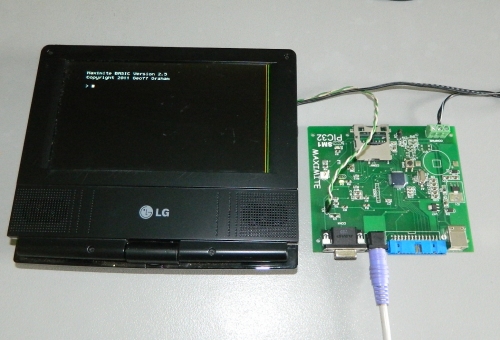

Posted: 12:03pm 12 Dec 2011
I'll be interested to see what they're like Glenn. I have a couple of much older composite 7" LCD screens here, and the trouble is that they are NTSC resolution. This pixelates the graphics a fair bit, to the point of being unreadable.
Geoff's support NTSC might work, I haven't tried that yet.

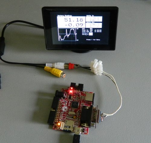

Posted: 03:14am 20 Dec 2011
The little LCD arived today, all the way from China.
Have to say, for the money, its pretty good! The unit has a few menu options, like brightness, contract, colour, and aspect ratio ( 16:9 or 4:3 ). Image clarity is good, though hard to see in the picture below.
