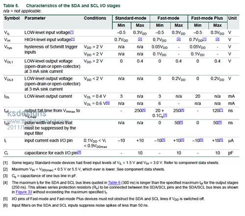

  Keith W. said   Regarding I2C SCL SDA input voltage specifications.
The data sheets for I2C devices that I am now using, from STMicro, NXP and Maxim, all specify the input high level (minimum) at 0.7 of the supply voltage. That is 3.5 volts required input with a 5 volt supply to the I2C chip.
I think an inadequate margin with only a 3.3 volt supply to the SCL and SDA pull up resistors. Yes it might work, sometimes.
Keith W.
From the I2c spec
I2c Spec
[1] Some legacy Standard-mode devices had fixed input levels of VIL = 1.5 V and VIH = 3.0 V. Refer to component data sheets.
ken
