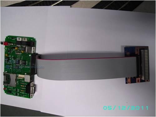

Here's a simple program to test each MM pin.

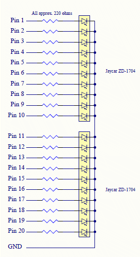

It just sets each pin as a digital out and toggles each pin high for 1/2 second then loops back and starts over. You can use your mutlimeter to chech that each pin goes high but I made up a simple circuit using two Jaycar ZD-1704 LED arrays and 20, 220 ohm resistors. I thought all my mini-MM pins were all soldered until I check them with this circuit. It turned out one wasn't soldered correctly. I drew a schematic but I'm having trouble getting it on this post.

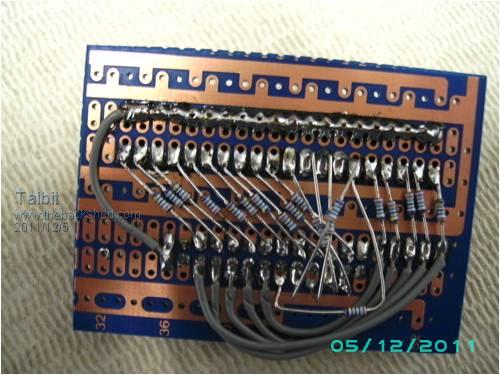

2011-12-05_140805_MM_Pin_Tester.pdf
This might do the trick. I tried to email you but came up with the same problem. I just made up a simple board and hardwired the resistors and the two LED arrays to the board. I mounted a 26 PIN IDC connector on the board and hardwired the resistors to the pins. Just be sure that you connect the correct resistor to the correct IDC pin. Then I just made up a flat cable with two IDC headers to plug into the MM and the LED board. Dead simple. I'll send a photo if you want.
Just let me know.

Talbit
Posted: 04:13am 05 Dec 2011
Here you go.

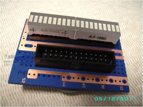

Pete,
Go to www.jaycar.com.au and search for ZD-1704 and it will give you some info. Any of your electronics suppliers like Mouser should be able to sell you the exact same thing.
You could wire up individual LEDs but it's a bit messy. I was going to do that but decided using the array would be much easier. I used two 20 pin IC sockets and then plug the arrays into them rather than connect directly to the pins of the arrays.
I'll send a photo when I get home tonight.
Talbit

Posted: 07:40am 05 Dec 2011
Pete,
This should give you an idea. Let me know if you want more.
Talbit

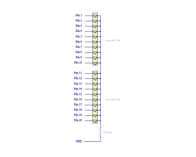

Hi,
If you really want to make it cheap....
Looking at the code only 1 led will be on at a time so you could directly Connect each MM line to the LEDs I.e forget the resistors and have just 1 220ohm resistor in the common leg of the LEDs...
Only works if it has one or two LEDs on at a time though.

Talbit
Joined: 07/06/2011
Posts: 210
Posted: 10:31pm 05 Dec 2011
This is Mick's idea of a simpler circuit. It should work the same.
Thanks also to BobDevries for the code.
It's only meant to test if all the pins are soldered correctly and there is continuity to the IDC connector. I guess if the pin works as a digital out, i.e. the LED lights up, then everything else should be okay with that pin.

Posts: 2984
Posted: 10:49pm 05 Dec 2011
  Talbit said
  bigmik said   Hi,
Mick, Not quite sure what you mean here. My guess is it should work exactly the same as mine with all the resistors.
Talbit
Hi Talbit,
I mean if Only one LED is ever on at the same time you will see no difference.. (This is the way the sample code is written)..
If Two LEDs are On at the same time they will probably still work but be slightly dimmer, 3 may work still but getting more than 4 or 5 on at the same time is unlikely to light any LEDs at all..
The Original 20 Resistors is `technically' a better solution and is more flexible but a bucket load more work to assemble..
Any way it is a simple option if you know its limitation.
