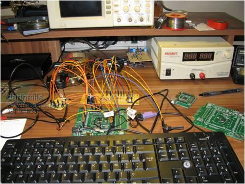

And a picture from my MM Chaos test bench
On this picture you see that i use a French AZERTY KB , can someone tell me where
i can get the UBW32 V2.7B source code that i can change the KB Layout ?
Actually only the source from the V2.7A is in the download list.
