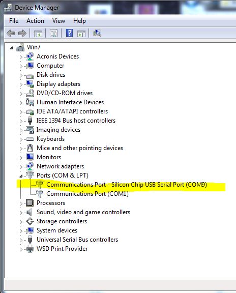

here's what I see under device manager in Windows7 ... I've highlighted the item
You may have to try a couple of times and disconnect the Maximite between tries before you get it to work .. I have encountered this with some other devices but not the Maximite.
Once you see this item in devices (note the COM port number for future reference) then you can proceed with the bootloader application and updating the Maximite to 2.7B
