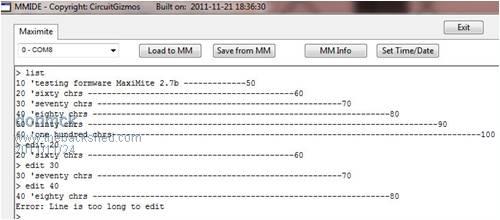

I don't have a MaxiMite in front of me to try, but could someone please tell me how many characters I can have on a line, and be able to edit, before I get a line too long error?

Posted: 01:15pm 23 Nov 2011
80 characters, including the line number. Just tested it on mine, but I'm still on 2.6D if that makes a difference, havn't updated.

Thanks Guys, I have one now and tested it on V2.7b:
Yes, 80 chrs.
