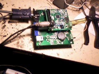

heres a little some thing to blow your mind

if yo want to add a rtc its possable as if you see the picture on this topic i acully have it mounted on top of a blown smi which i modded to run vga ket board and the rtc ...U11..was the origanal setup input for the rtc ig nore this connector as it is not wired to the chip correct pins remove the two 2.7 k resistors next to U11 dont use this in put as the rtc wires have to go to the pins on the 26 way hedder ....you dont have to cut any tracks just if you get one of thaose already made boards rtc that is there is a lot of documentation "on the rtc posts if you really get stuck just post here and i will look at how i did it and so but read the posts first....
